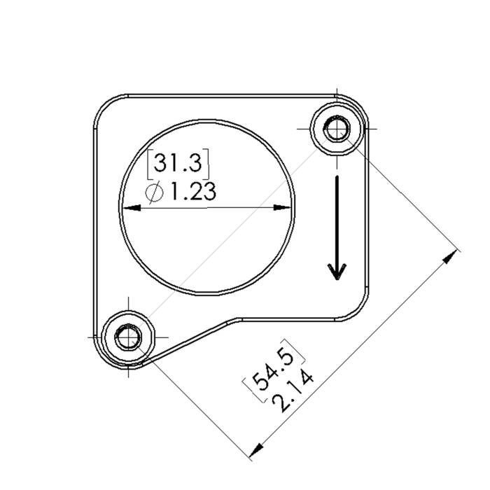

To start you will want some solid aluminum piping material. I went with some 6061 which welds nicely and is of high quality. I purchased a 2ft long 90 degree piece that was 3.5" diameter and a weld on MAF flange made for 3.5" pipe.
MRP performance seems to make very very nice quality weld on MAF flanges and that is who I chose for that. Then I cut the pipe at an angle best suited to aim the intake from the turbo outward from the block. I had no special tools for this but just simply tried to go for what I felt like was a cut to make one half have a 60* bend and the other half have a 30* bend. I used a little band saw I have and it ripped right through it but barely fit lol
(After having it mocked up it would be better to cut it at a sharper angle or make sure your 60 is 60 degrees as mine seemed shy and isn't quite as angled as I would like)
A belt sander would be my preferred method to make the cut nice and flat afterwards but I had to use a flap disc on a 4.5" grinder and use the ol' eyeball method haha After that I checked with a mazda homie on how far his MAF sensor was from the end of his intake and he said about 4" and has had no issue and doesn't have an air straightener, so I went with that or more. I pre-drilled a pilot hole for my hole saw and cut a hole that was the same inside diameter as the maf flange hole. The hole size should be one and a quarter inches so 1.25".
